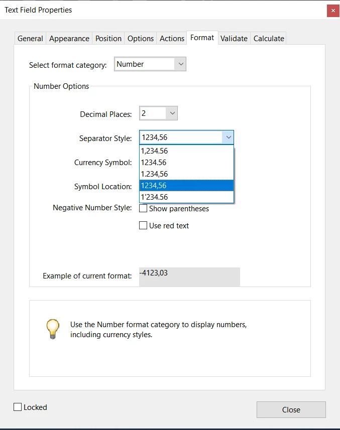

If you want to write , and field to show , but to calculate as decimal try select this option:
12 replies

Nesa NuraniCommunity ExpertCorrect answer
March 9, 2021

Why not simply use the built-in Format option that has a comma as the decimal separator? That will allow you to enter the value directly with the comma, and will handle it correctly in later calculations.

Tried that. If I write 2,3 it gives me back 23.00?

What option did you select under the Format tab?
