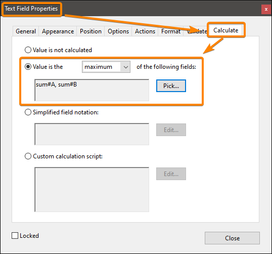

You don't need any JavaScript for doing this, just use the "Maximum" Acrobat's calculation:
