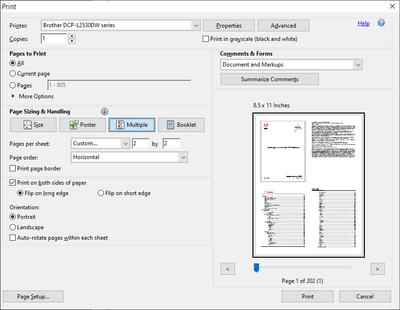

Use the Multiple option in the Print dialog. For example:

Jul 09, 2023 Jul 09, 2023
