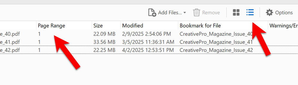

Apr 15, 2025 Apr 15, 2025
At the column Page Range you can specify the pages for the combination.
Community Beginner ,
That is what I am looking for. Where is this documented? Everything I find only talks about thumbnail view options.
Use the list view.
