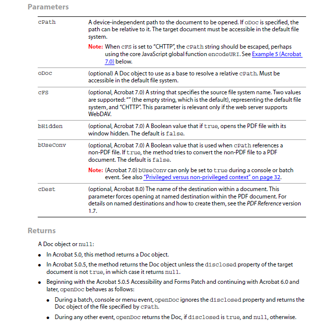

I strongly suspect the "app.openDoc()" function is throwing an exception because the 2nd argument for this function is a document object that is used to resolve a relative path.  The "bHidden" argument is the 4th input. So Acrobat is likely choking on the 2nd input, which is the bHidden variable. Please refer to the reference entry you've posted above.
I think what you meant to write was this:
var doc = app.openDoc({cPath:"doc2.pdf", bHidden:false}) ;
The Acrobat model allows some function arguments to be passed by object, using named parameters. Some functions in the model have huge numbers of entries, and this notation provides a method for entering only the needed arguments.

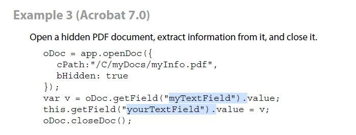

Pls take a look at the example from the documentation
This is my original code
oDoc = app.openDoc({
cpath:"1.pdf",
bHidden:true
var v = oDoc.getField("Text1").value;
this.getField("Text1").value = v;
oDoc.closeDoc();
but not working... Do you know why?

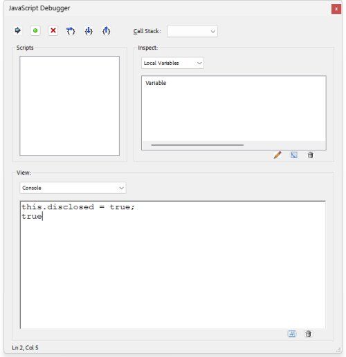

Jan 12, 2024 Jan 12, 2024
Open the document.
In the Javascript console execute:
this.disclosed = true;
Save the document.
I did that.
NotAllowedError: Security settings prevent access to this property or method.
Doc.disclosed:1:Field Button1:Mouse Enter
Jan 13, 2024 Jan 13, 2024
Use the Javascript console:
You need to place that code as a doc-level script, not run it from a button.
So you've already seen that the "app.openDoc" only returns the document object when run from a privileged context, or if the document is disclosed, i.e., the document being opened is already disclosed.
So, as pointed out by Try67, the document being opened must have a document level script that sets the disclosed property to true. The document has to have been setup with this script before it is opened from the script in the button.   This is I believe the final issue with your code.
