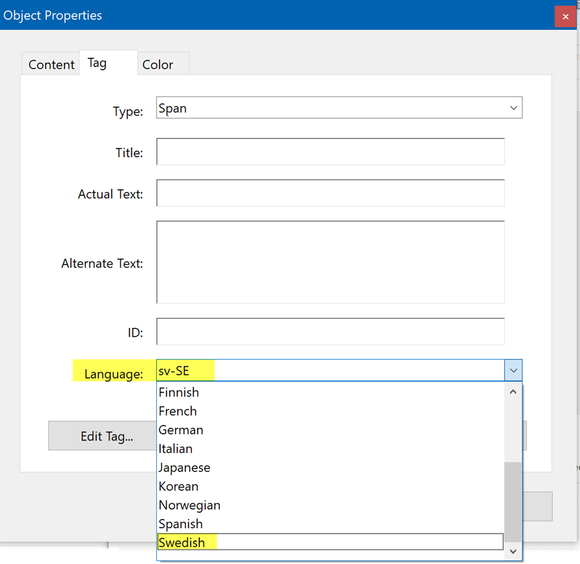

  3. The Sweedish sample has the Language attribute applied to the <Span> tag, which is a recommended method. But it's coded as sv-SE rather thant SV (which is what you'll see if you select Sweedish from the drop-down menu). I'm not familiar with Nordic languages in PDFs, but having worked with other languages, I know that the exact spelling of the language's abbreviation is sometimes critical. Since Adobe writes the PDF and PDF/UA standards, I'd trust what Acrobat gives, not Libre Office which is an open source program and might not be correctly encoding your PDFs to the PDF standards.
    Set the language on the TAG tab.Set the language on the TAG tab.

sv-SE is the code for Swedish that is spoken in Sweden in the same way as en-GB is for British English and en-US is for American English. It is shown as code, because Acrobat does not have a "clear-text" mapping for that language code, but it is a standard language code. Finland is a bilingual country and code for Sweden spoken in Finland is sv-FI. The difference is small and so I often mark text as 'official' swedish for compatibility reasons.
