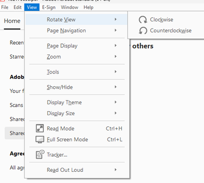

I have Continuous Release Version 2023.001.20143 64-bit on my computers. One computer works normally, and I can view the option to "Enable New Acrobat" under the View menu. The other computer with the exact same version is missing this option and there is no way to enable the new Acrobat. Is there a way to make the option appear?

Currently, the new experience is being rolled out as an experiment and available for Acrobat (64-bit) English locale only with no third-party plug-ins installed. The feature may not be available to all users. For more info. please check the help page https://helpx.adobe.com/acrobat/using/new-acrobat-experience.html

Sorry if this a stupid reply, but the link doesn't reference that option you've advised in that link I don't see anything it in referencing it. Could you tell where exactly I set that option?
Engaged ,
Oct 22, 2023 Oct 22, 2023
bIsEnterpriseUser is the same place. HKEY_CURRENT_USER\Software\Adobe\Adobe Acrobat\DC\AVGeneral
set that to 0, then set bEnableAv2 to 1.
