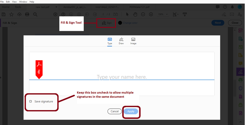

Ok.
Use this guidance as an example of the workflow you're tying to achieve: https://helpx.adobe.com/sign/how-to/use-fill-and-sign.html
Just make sure that when the signers arrive at the site,  have them sign the document using Fill & Sign.
Ensure that the tick box "Save signature" is not checked.
  See image below:
If you keep "Save signature" the first person that signs the document will lock the document and it will be no way of working around this if you will be using Adobe Reader on the device that will be used for signing.

I do have a paid subscription but this will be a form on a live construction site.  I need a generic form which I wouldn't assign the "signature" slot to each person as that would be a huge amout of admin work, I just need each person to input their own name and then sign the next line down on the form

Ok.
  See image below:
