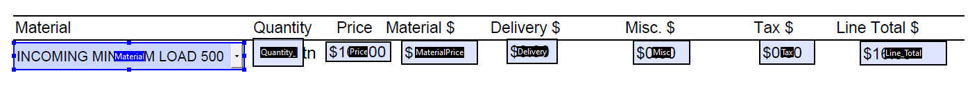

Greetings,
I am creating a PDF but having some techincal issues.
Here is an image for reference.
There is a dropdown list named Materials. I would like the Material Price and the Line Total to be set to $58.00 when you've picked INCOMING MINIMUM LOAD 500.
So far i've tried this script to no avail,
var f = this.getfield("Material");
switch(event.value){
case "INCOMING MINIMUM LOAD 500 ":
f.setMaterialPrice(58);
Any help would be greatly appreciated!

try67
July 11, 2022
You can't just invent stuff and expect it to work.
setMaterialPrice is not the name of a Field object's method.
To set a field's value you must use the value property, like this:
f.value = 58;
Also, JS is case-sensitive, so "getfield" will not work. It's "getField".
And using a switch for a single comparison doesn't make sense, either. Use an if command.

Bernd Alheit
July 11, 2022
Check the Javascript console for errors.
July 11, 2022
It says Syntax error 7: At line 9 when i attempt to insert the code.
Bernd Alheit
July 12, 2022
The end of the switch is missing.
