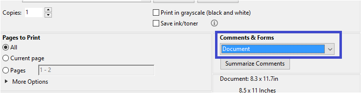

Also, please make sure that the right option is selected under the "Comment & Forms" drop-down menu in the Print window.
