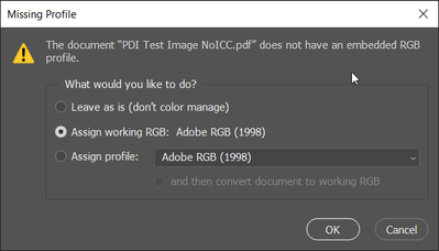

  • If I pull an image out of the PDF and into Photoshop, Photoshop warns me there’s no embedded RGB profile. If I assign AdobeRGB (my working space), the print looks right.
  • If I export the whole PDF as a JPEG with AdobeRGB embedded, that prints correctly too.
So my guess is the PDF images are DeviceRGB with no ICC profile. Acrobat/Foxit fall back to sRGB, while Photoshop lets me assign AdobeRGB and get a good print.

I applied flattener.  The change took hold, as evident in the first screenshot.  However, the print is still flat.  To further test, I saved the file, reopened the PDF.  The change, whatever it was,  persisted.  However,  Photoshop sees no embedded color in the image/file, as is evident in the second image.
