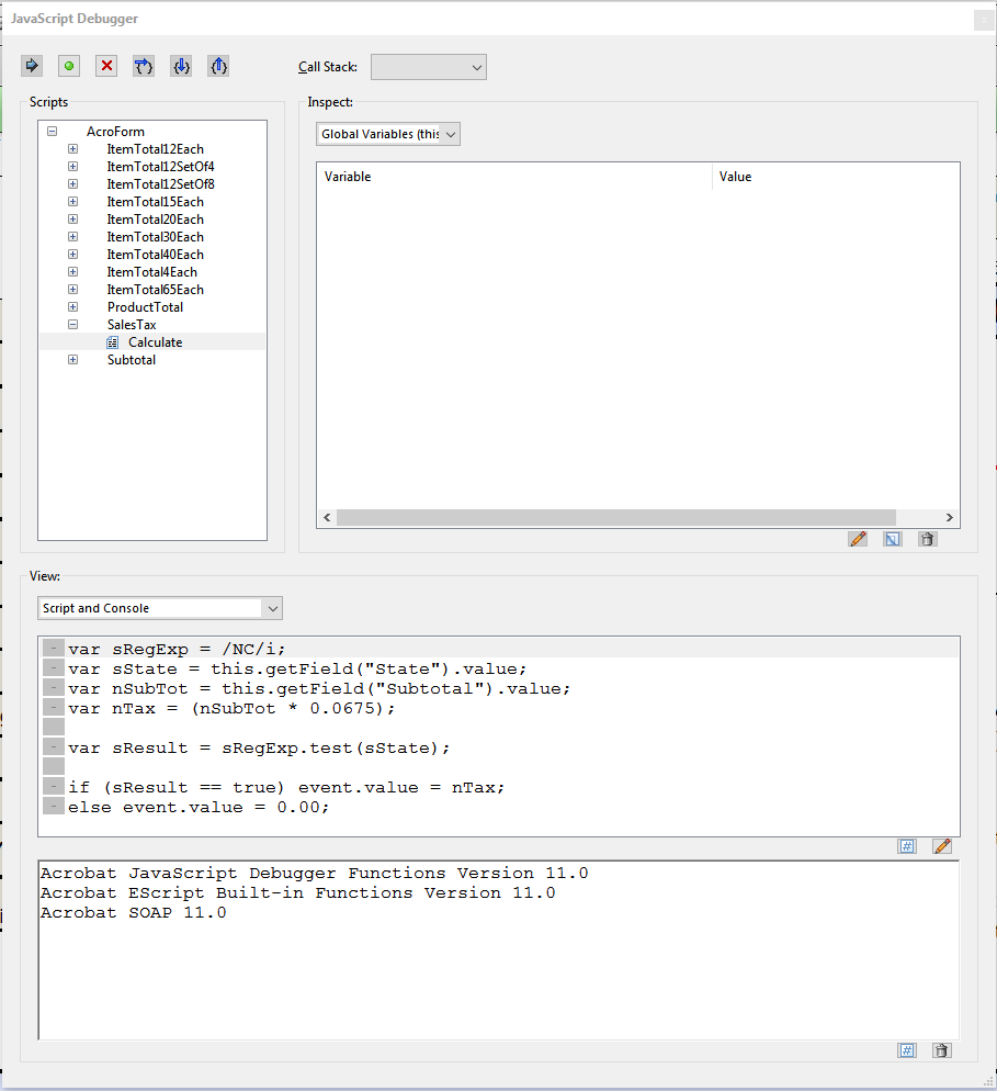

try67,
Opened the Console and clicked on the -> button, but nothing happened. I changed a couple of values on the form and again, nothing happens. I get no errors, no warnings, nothing. The variables don't show in the upper right window either. It is almost as if the script does not even run!
Here is a screenshot of the console with the line with the issues selected in the console window.

New Here ,
Apr 03, 2017 Apr 03, 2017
try67,
I put the code in the console window and ran it. This time, I got a result... the one I was expecting, if the "State" field contains NC, then the tax is calculated.
So, it seems that ALL of your help has somehow solved the problem!!  I appreciate your time and assistance.
Forever in your debt.....
-DON-
