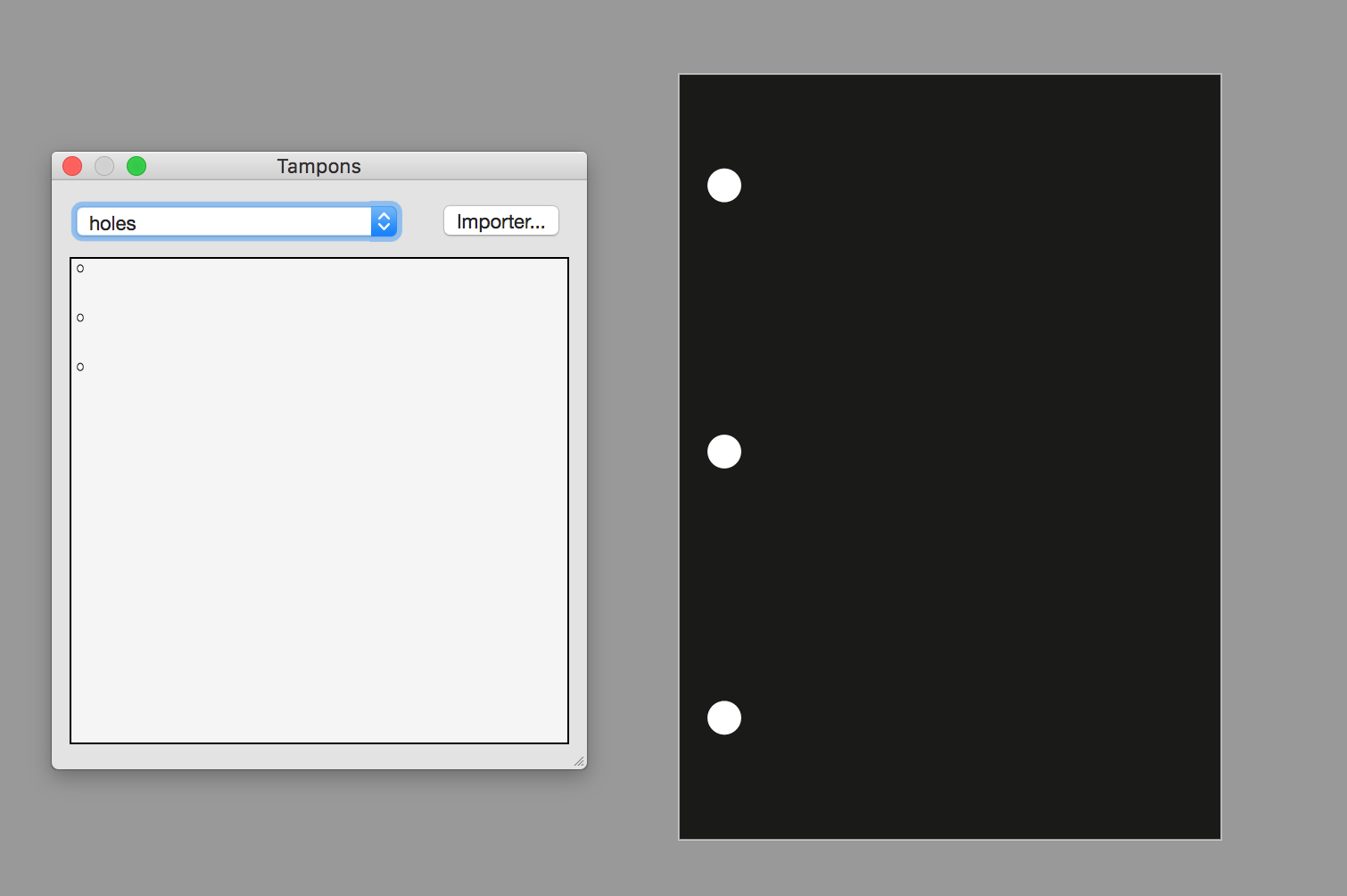

I guess you could create a custom stamp and add it prior to print ?
If you need something more automated, you could try to use an action or go to PDF apps such as Enfocsu PitStop or Callas PDFToolBox
