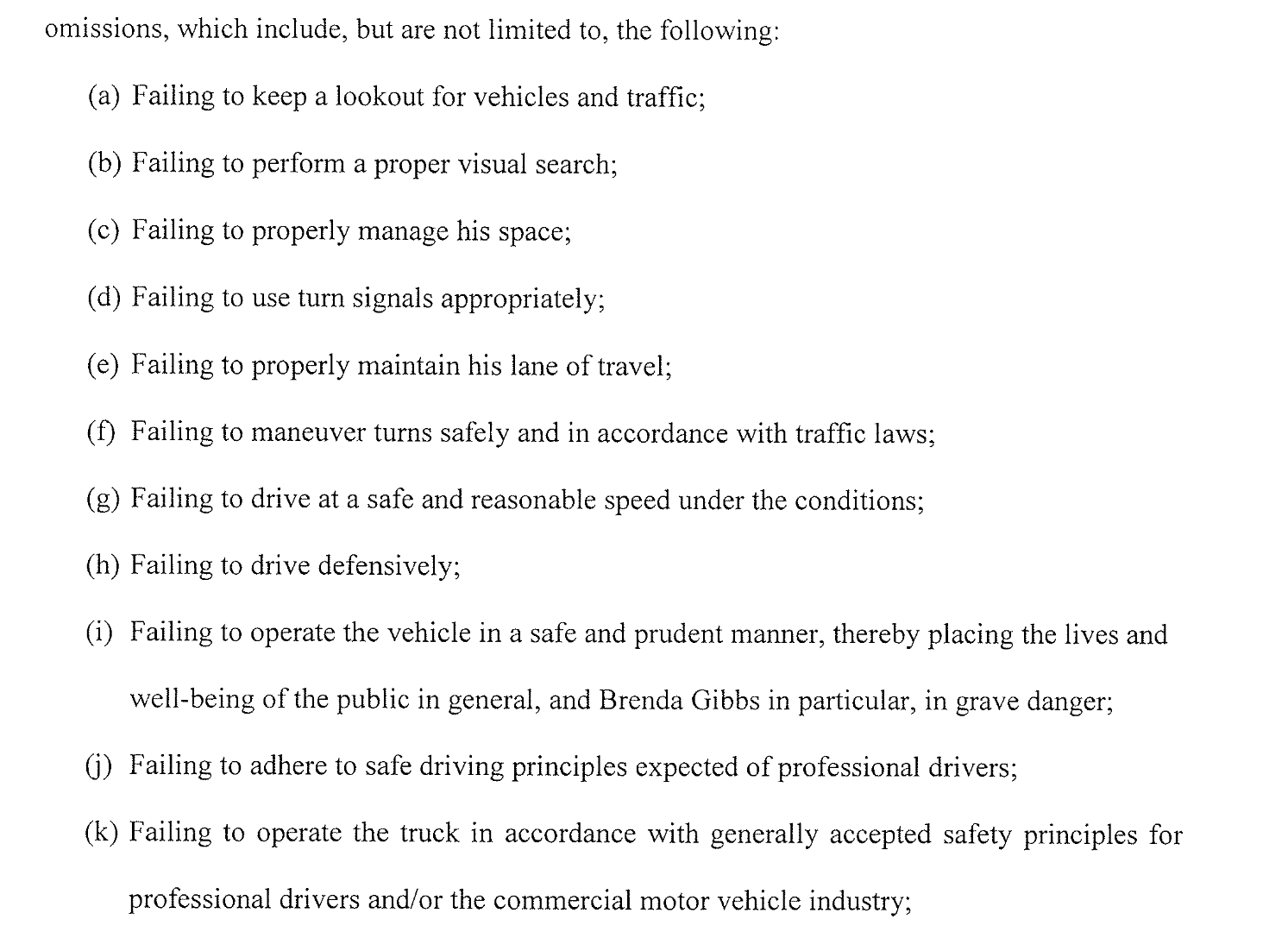

Looking very closely at the document, it looks like the first page is in a slightly darker format and all the other pages are grayer, like it's not part of a searchable document, even though it's all loaded and you can see it.  Here's a screenshot of the first page with redactions:
and a screenshot of another page in the document:
It might be hard to tell, but everything after the first page definitely looks more grayed-out.
Apr 25, 2018 Apr 25, 2018
The fact you can see and read it doesn't mean much. Please answer my questions from above.
I assume you can't select the text at all. That means it's a part of an image, and not real text, which is why the Redact Text and Find tools can't see it. You will need to run Text Recognition on those pages to be able to use them.
