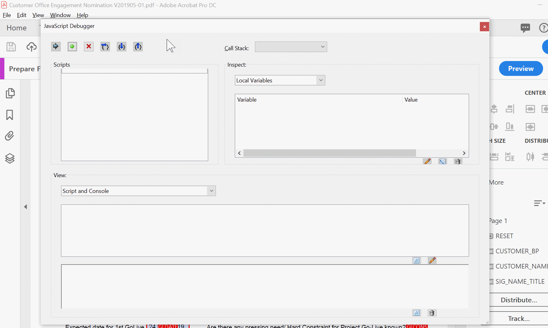

Community Beginner ,
May 13, 2019 May 13, 2019
This is the screen with the debugger. Where should I enter the script as it does not allow me to type anywhere.
Thank you
What happens when you type in the field at the bottom?
It does not allow me to type in any of the fields.
Repair your Acrobat installation.
Go to Edit - Preferences - JavaScript and tick "Enable interactive console".
That worked. Thank you.
