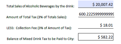

I've tried formating, adding in various suggest code/script but nothing is working,  I've read previous posts about how the code/script worked for them but it is not working for me.

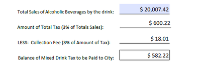

The numbers are displaying with 2 decimals but when you click on the field is shows the 14 decimal places.  This throws up the simple view (of 2 decimals) when calculating.
In the example below, a user will enter the 'total sales' (field 1:  $20,007.42 ),  the 'total tax' is 3% of 'total sales' (field 2:  $600.22 displayed/formatted for 2 decimals but when you click on the field you see it is actual the real number  is: $600.2225999999999), the 'collection fee' is 3% of the 'total tax' (field 3:  $18.01 displayed but real number is: $18.006677999999997), and the 'balance' is 'total tax' minus 'collection fee' (field 4:  $582.22 displayed/formatted for 2 decimals, real number is:  $582.215922).
When you look at it with 2 decimals (currency), the 'balance' does not add up (600.22 - 18.01 should equal 582.21 not 582.22).  I understand why it is happening, I just dont know how to fix the decimal precision in the calculation to ONLY use 2 decimals.

If your fields are formatted as numbers, you don't need to use valueAsString then convert to a number.  Just use value (eg. this.getField("Total Tax").value.  If you do convert a string to a number the n in Number is supposed to be capitalized.  In your sample script you declared the var1 variable twice.  To answer your question, the 2-decimal formatting only formats the number.  The value of the field is the actual value (with all the decimal places).  If you want the actual value rounded to 2 decimal places you would use Math.round( ) like this:
event.value=Math.round(this.getField("TotalSales").value*.03*100)/100;
Then your equation will display the result you want.  100)/100 is rounding to two decimal places.  For 1 decimal place, change the 100s to 10s and for 3 decimals, change the 100s to 1000s, etc.

Wow...ok i feel really dumb.  I also noticed that the 'valueasstring' should have been 'valueAsString'.  I think i was looking at this too long.  Thank you for the simple solution (that was staring at me the past couple of days).
