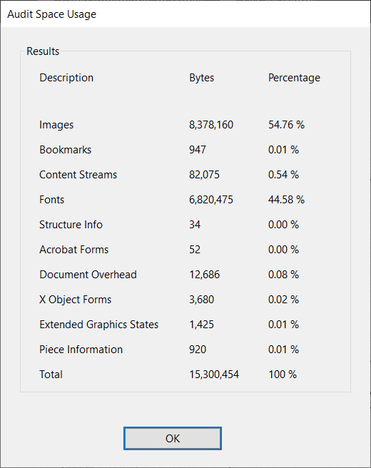

Compression is not a magical process. Some things can't be compressed, such as fonts. If you have embedded fonts in your file that take that much space the only way to reduce the file-size would be to subset them or to switch to other fonts entirely. Also, not all images (eg. vector-based images) can be compressed.
You should start by inspecting the file in order to figure out what takes most of the space in it. To do that, open the Content panel, then right-click the top-most item and select Audit Space Usage. You will get a window like this:
This should give you a good indication on how to proceed.

Thank you - I solved it by creating an old school PostScript file and ran it through the Distiller - that worked magic - the file is now 2 MB
