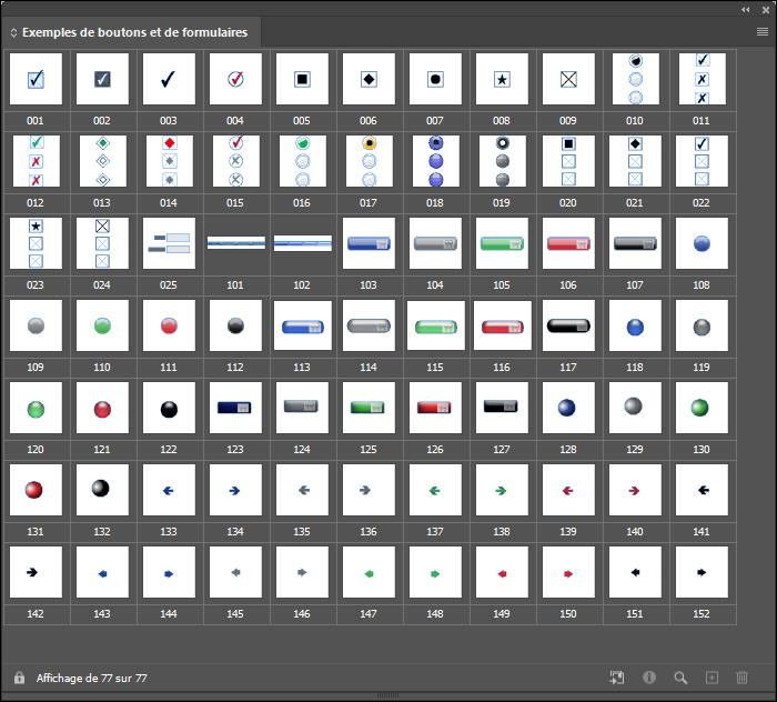

Here are the examples of buttons and form fields proposed by InDesign. You can also modify them or make custom creations.
But in InDesign there is no warning that most them are not compatible with the PDF format, it is up to the users to guess or to find out.
Copy link to clipboard
Copied
They are just asking for unhappy customers. You have to wonder why they do it.
Copied
They were designed for SWF and ePUB exports.
