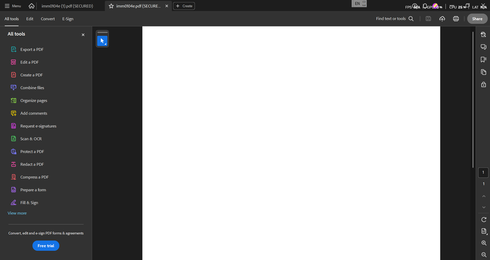

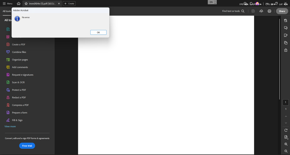

Hi, I also has a similar problem, but I think more complicated. This is the General Education and Employment form from Study permit. I downloaded the correct version of the file and acrobat reader it requireed, but some how I can't open it with th reader and it shows completely blank. On the name SECURED is added to the end, but I believe this file is not at all.
New Here ,
Jun 10, 2025 Jun 10, 2025
Other pdf in the Study permit process works fine with the reader, so I think it just this specific pdf (the General education and Employment Form) that is not compatible some how.
Adobe Employee ,
Jun 17, 2025 Jun 17, 2025
Hello!
I hope you are doing well.
Since other PDFs in the Study Permit process are working fine with Acrobat Reader, it does sound like the issue is specific to the General Education and Employment Form. This could be due to how that particular PDF was created or saved; it might contain non-standard form fields, embedded scripts, or elements that aren't fully compatible with Adobe Reader.
Try Opening in Acrobat Pro or another PDF Viewer like Browsers: If you have access to Acrobat Pro, try opening the file there to see if it behaves differently.
Check for JavaScript or Dynamic XFA Forms: Some government forms use XFA (XML Forms Architecture), which is not supported in all PDF viewers. If the form uses XFA, you’ll need to open it in Adobe Acrobat (not Reader) or Adobe Reader with enhanced support enabled
You may have to reach out to the website support to get another version of the PDF file.
I hope this helps.
