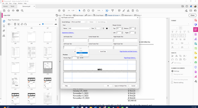

Oct 07, 2022 Oct 07, 2022
I cannot paste from Word to the header/footer field.  The menu highlights paste, but nothing happens.  This started a few months ago.  Any suggestions?
Community Beginner ,
Sep 19, 2023 Sep 19, 2023
Win Taste + V paste
