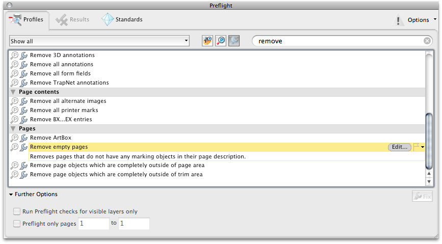

As the solution provided above does not help, you can remove the blank pages in Adobe Acrobat DC.
Go to Tools > Organize pages.
Then select the blank pages and delete them using the trash icon in the toolbar at the top.
You can also use the Preflight tool to remove the blank pages from the PDF as mentioned in reply 3.
Go to Tools > Optimize PDF > Preflight.
Then click on "Select single checks" icon shown in the screenshot below:
Then go to Pages and click on it.
Select "Remove empty pages" and click on Fix at the bottom right of the Preflight window.
