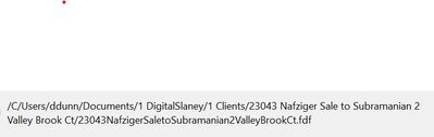

Jul 07, 2023 Jul 07, 2023
Here are the four fdf files being exported. The script camel-cases the file name. The images are in the order in which they are to be saved.
