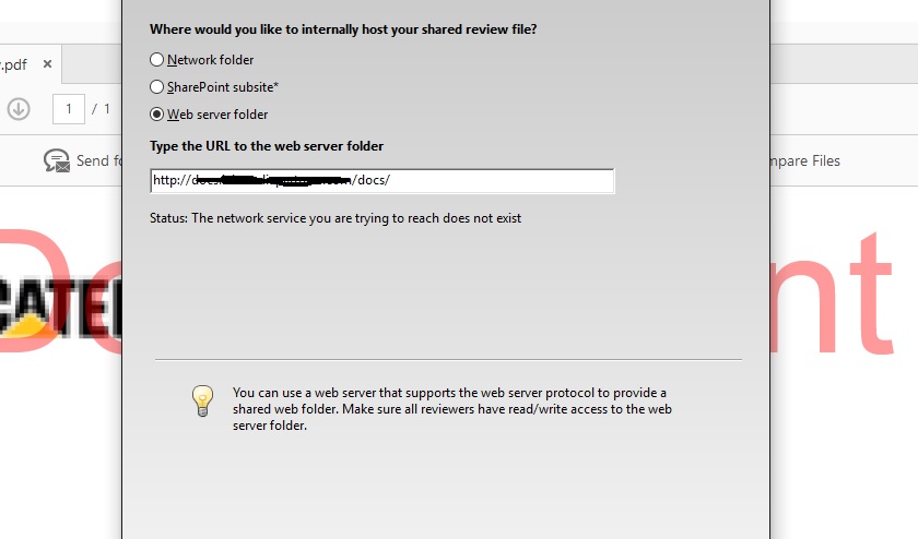

I was using Adobe Acrobat 9 and my shared reviews where working fine with WebDav server. Two days before i installed the new acrobat pro DC version with update 2015.023.20070 my shared review is not working. I cannot able to connect my webdav server when creating new shared review pdf. My iis logs is telling.
2017-04-11 16:24:36 <our server> PROPFIND /docs/com.adobe.acrobat.webdav.writeability.txt - 80 - 12.159.252.170 Mozilla/3.0+(compatible;+Acrobat+Annots+17.9.20044+) - 404 0 2 15
2017-04-11 16:29:10 <our server>PUT /TestWebDav/com.adobe.acrobat.webdav.writeability.txt - 80 - 76.92.166.64 Mozilla/3.0+(compatible;+Acrobat+Annots+8.0) - 401 0 5 218

Thanks for your support. I have already tried weddav server in other browsers its working fine. I have attached the screen shots of error for your reference as well as latest version names. Also please let us know does the new Pro DC requires any authentication as must in webDav server?.
