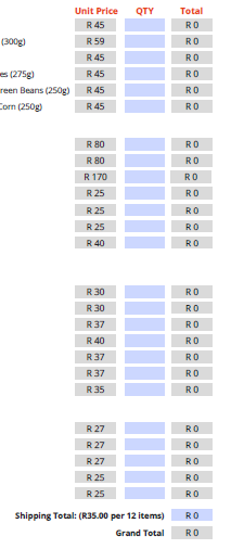

Hi Everyone,
How do I calculate a certain number of form fields? As you can see below, the shipping field; for every 1 to 12 items, the number should calculate R35. So, if there is 13 to 24 items it should calculate R70, and so on. How do I calculate this in the field properties? What is the formula for this?
This must be based on the quantity of the items number and NOT just based on the quantity fields number.
2016-11-21 01_56_59-My Body Guru Order Form_161121.pdf - Adobe Acrobat Pro DC.png
Thank you.

Community Beginner ,
Nov 20, 2016 Nov 20, 2016
Hi try67,
Thank you for answering my question. We are almost there, but what I need here is the calculation for the numbers in the quantity fields and NOT the quantity fields boxes itself. For example, Qty1 is 8, Qty2 is 10, Qty3 is 5, and so on (see below for sample).
Can you provide me the calculation if the overall sum of Qty fields divided by 12 and for each 12 multiples the shipping field is calculated as R35, R70, R105, etc.
For example,
Total quantity is 83. 83 divided by 12 = 6.9 (so 7 when rounded to). 7 x R35 = R245
Hope this makes sense.
2016-11-21 11_49_45-My Body Guru Order Form_161121.pdf - Adobe Acrobat Pro DC.png
