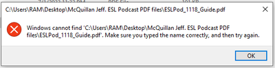

I recently cleaned my laptop Win 10 OS thru tune-up and also thru windows disk clean up and defragmented my C drive and registry. Everything was fine but now I'm unable to open PDF thru adobe reader although PDFs are being opened with other readers Eg. Edge, Nitro.
It keeps displaying this error (screenshot attached) and doesn't make any sense.
How can I resolve it? I uninstalled deleted Adobe folders from Local, Roaming, and program files restarted and reinstalled even tried checking in compatibility Win 8 and run as administrator. Still no luck.

I cleaned it with Acrobat cleaner tool (removed reader) and restarted then installed Adobe this time I have changed the location to E:/ instead of C:/ still same error.
I did creat another profile and there it displayed adobe is already installed and when I open PDF files it displays the same error.

I have the same issue with pdf files,

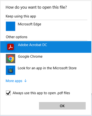

You can solve it by right click on the pdf file - open with - Choose another app:
From the list choose Adobe reader as below :
