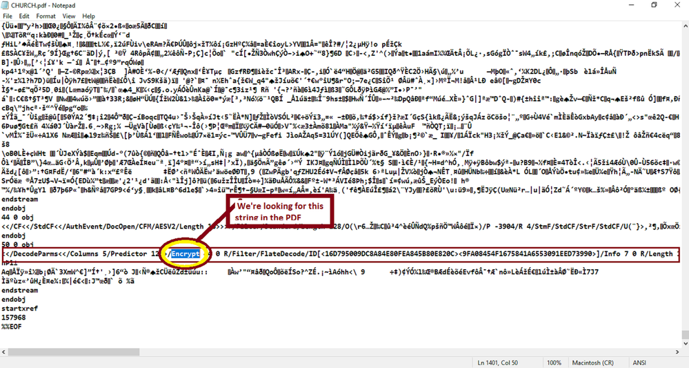

Right-click on a PDF file in your Windows box and opn it with a text editor such as Notepad or Notepad++, for example.
Once you have it open You can hit the "CTRL" + "F" in your keyboard to perform a  search for the string "Encrypt"
The slide below helps illustrate:
This string descriptor is what is letting us know if this file is actually password protected or not.
