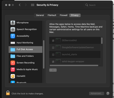

Which version of OSX are you using as there may be additional rights that you need to give to distiller, such as  Full Disk Access or Files and Folders.

I'm using macOS Mojave (10.14.6). I've tried enabling full disk access, to no available.
