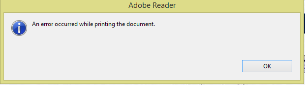

Are your documents graphics heavy or mostly text? Can you try printing to other printers (other printer model/maker)? Who generated the documents (you, external service provider on demand, vendor selling the document also to others)?
How is the Kyocera printer connected to the computer? If networked, try a direct connection. If a direct connection, try a networked connection.
How big is the print queue on your system during such a print?
Is the error generated by Acrobat or by the printing subsystem? Can you post a snapshot of the error message?
