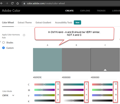

Hi! I wanted to use a color wheel at Adobe Color site. I needed a color palette in CMYK. I set CMYK in Adobe Color in the lower left corner on the site. But the color wheel on the site looks nowhere near like CMYK. Colors are vibrant like in RGB, not faded as in CMYK. How to see this color wheel in CMYK colors? I don't want to see those CMYK colors only after importing to PS or AI. I want to see it at Adobe Color site to match my colors better, because this site is very useful. Do you have any idea how to do this?
In the first attachment it is a screenshot of the color wheel in Adobe Color described as CMYK with too vibrant colors to be the real CMYK. In the second attachment, in comparison, it is a a screenshot from the CMYK color wheel in Adobe Illustrator, with faded shades as I would like to see in Adobe Color, but sadly I don't...

The CMYK values are not going to be viable in this application.  They are not based on any standard print proceess, and should not be used.   Instead set up the color you want as a spot color in InDesign or Illustrator, then convert them to CMYK using the correct profile on export to PDF.

Hi @Fraglessina , in case you are still following this thread, the reason for Adobe Color’s limited color management is that it is a web based app and browser color management is very limited.
If you want to accurately color manage your themes, set their color mode to Lab and let the Adobe app make the conversion to your CMYK output profile. For example here I’ve made a theme named Compound 3 in Lab mode, and in InDesign I’ve added the theme to my Swatches panel.
My document’s CMYK profile assignment is Coated GRACol 2006 and InDesign’s Separation Preview shows the color managed GRACol output numbers while maintaining the theme’s original color appearance.

Hi @jahnemichael , Because of the limitations of HTML code displayed in a browser, it’s not a problem Adobe can likely solve in a Web application. There are no color management or profiling options for HTML color—an image can have an embedded profile, which the most browsers will honor, but there are no CSS or HTML properties for assigning CMYK profiles or color managing CMYK color conversions.
If you want to accurately color manage themes, try working in Lab and make the CMYK conversions in your Adobe app—see my previous post.

The article you linked to is referring to how browsers color manage and display images with embedded profiles—an image with an embedded profile will display in the embedded space in most browsers.
But, there are no images to profile in the Adobe Color site, the displayed swatches are HTML DIVs with background color values defined as RGB. In general modern browsers display CSS coded color as sRGB via the monitor profile. There isn’t a CSS code option to assign an RGB profile to an HTML DIV or display a CMYK color with an assigned profile—everything is sRGB.
If you look at the source code for an Adobe Color page, you can see the swatch CSS background values are defined as an rgb(N,N,N) even when the color mode is set to CMYK. No profile embedding can happen in the CSS coding:
