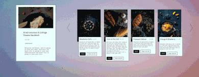

Remember how you could previously define a fixed padding for a group and the background would scale as you changed the content?
Now, imagine if the icon in the above image were to be placed to the right of the text. Editing the text would resize the background for sure but would not maintain the relative space between the text and the icon.
Using stacks, you can define spaces between grouped objects that are respected when you move or reorder them. So, now when you update the text in that button, the image grouped with it maintains the defined distance.
And yes, you can nest stacks or apply them to components. The image below describes some possibilities.
