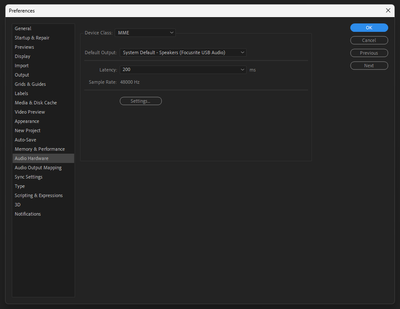

Explorateur ,
Feb 25, 2024 Feb 25, 2024
It seems that the freezing issue has been resolved. Hasn't come back yet.
But the cracking sound whilst previewing is still there. I'm using Focusrite Scarlett 2i2 with its latest drivers.
Audio Hardware settings:
Audio Output Mapping settings:
And the cracking sound only occurs in After Effects during preview.
