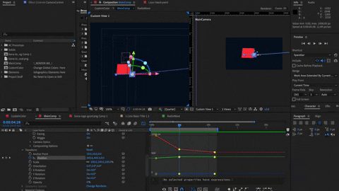

I've just hidden the map, created a flat red square and checked 3d for that layer. I've also turned on split screen preview so you can see the camera's behavior. All movement is done with the camera. You can see how the camera wireframe is moving slow, then fast, then slow between the 2 linear interpolation keyframes.
https://media2.giphy.com/media/zZJEkKlFhMzw0gSGSm/giphy.gif?cid=790b7611ae1d175f42c342699ffe536d5e6b...
How is the camera moving at different speeds (slow fast slow) between two linear time and linear space keyframes?
New Here ,
Oct 07, 2021 Oct 07, 2021
Ah! I've discovered the problem. Easing was turned on for the camera control. Turning this off makes everything work how I would expect it works.
