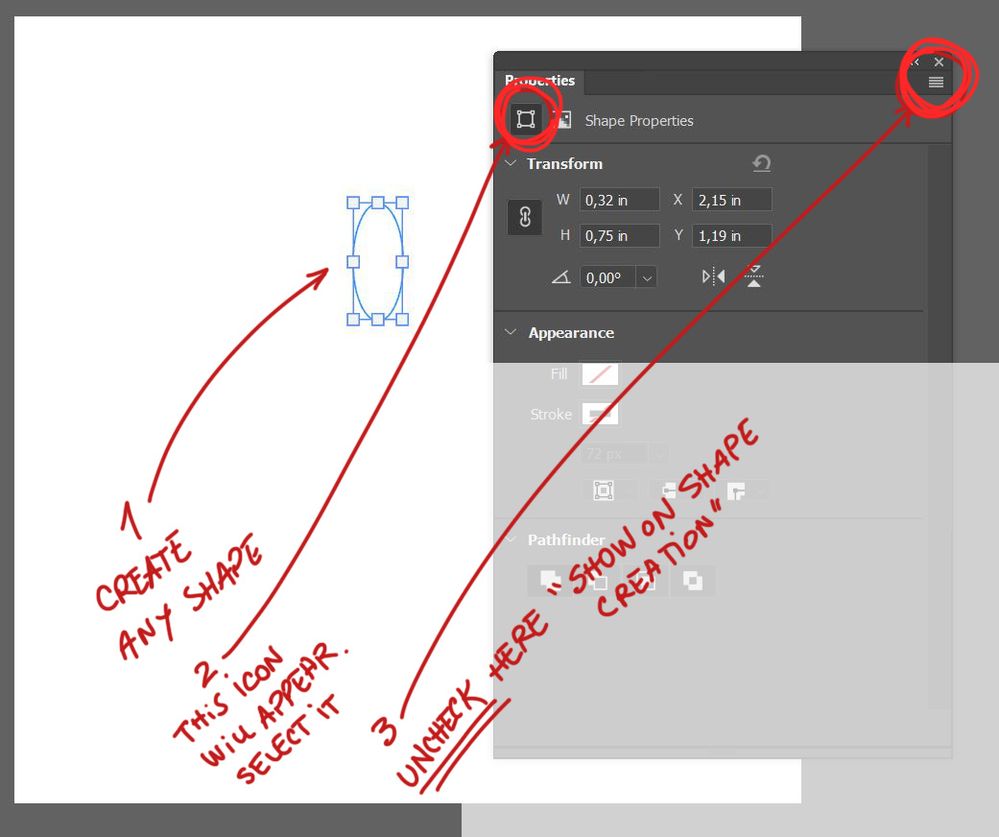

This button

thank you TimurKo.

Thank you for sending a screen grab of the location for the check off option. I kept looking for the check off option on the properties window itself. Or looking in the preferences options.

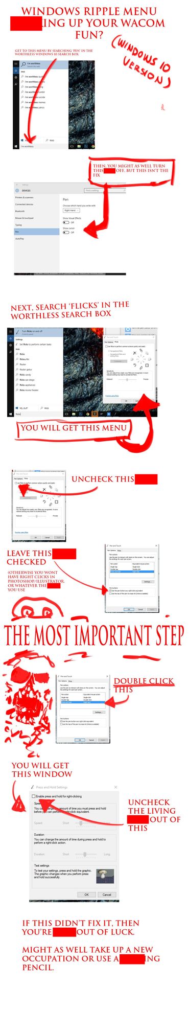

Having more than one nebulous vector to try and tackle this After Effects work-interference issue reminds me of the backflips you had to do to get your Cintiq (or other Wacom tablet) working in Windows 10 after Microsoft rolled out Surface and started fooling around with shoving pen crap everywhere throughout your desktop OS. The Adobe bungle is admittedly nowhere near as egregious, but it's still a very similar brand of aggravation.
It may have been around 2014 (or even eariler?) that some helpful soul posted the steps below somewhere on the web and saved a lot of Windows10/Wacom-using artists a whole lot of misery. I downloaded it and kept it on local storage in order to never, ever lose this lifeline, so unfortunately I'm unable to give credit to the angel who helped us all. Reposting here for yuks because it:
  1. was so carthartic at the time (while being of immeasurable help!).
  2. is funny to me today, now that I'm not currently completely screwed by my OS/drivers with nowhere to turn while desperately trying to figure out how to get back to work churning out 100 storyboard panels a day.
I hope the original poster realizes how many people they helped at the time. I'll always be grateful.
Vintage Windows 10 Wacom HiJinksVintage Windows 10 Wacom HiJinks
Note:
Back in the day, a "pencil" wasn't a 30-years-late-in-the-game Apple-developed variation of the stylus long-familiar to career digital artists of all stripes: it was a core of graphite wrapped in a wood sheath. When you dragged the exposed graphite tip across a sheet of paper, the graphite ablated and rubbed off onto the paper's surface, making visible marks, and people used pencils for writing and drawing.
New Here ,

Just to clarify this:
Both the Shape Tools and the Type Tool have an auto open panels button. You have to turn off the switch once for each of those tools and then it will stay disabled until you reset your preferences.
A single location or turning this option off/on in preferences would be beneficial.
