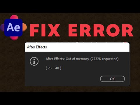

Here is a Video that might help
Ae #error How to fix Out of memory (2732K requested) (23::40) in Adobe After Effects Watch the video to find out how it's done 👆 Click here to subscribe 👇 https://www.youtube.com/channel/UC-dmWzJoIwhle6u6qFLb4pw?sub_confirmation=1 Follow me on Instagram: https://goo.su/zze8d Follow me on Facebook:
