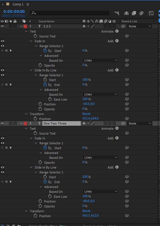

Im trying to animate text layers, the problem is whenever I add numbers to a layer, it's either animating too fast or too slow compared to ther layers.
The keyframes in the exact same location, the only difference is the content of each layer.
Thank you for your help

If you twirl down the "Slide Left by Line" animator you might see a Position parameter in there. Is the value the same for both layers? If not, then try making them the same.

It's at the same position, just slightly late or early

As a test, what happens if you duplicate one of the lines and change the text? Do you see the same results as in your screen recording or is it  what you expect to see?

I tried to duplicate a line, putting only text in it (no numbers),  worked fine. Then added numbers, and it was late.

It looks like you may have some easing applied to the Animators, or are using an inappropriate wave shape.  Can you post a still screengrab of the timeline after pressing UU on each layer to reveal all edited parameters?
