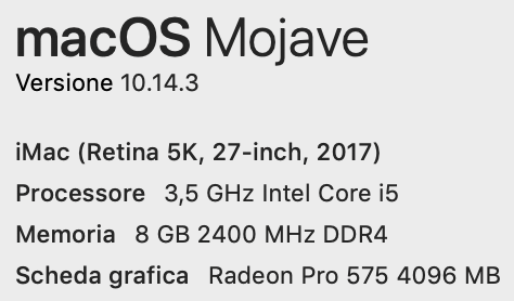

I have a simple video in which three images should slowly move from the right to the left, without any transition nor complicate elements (the most complicated thing is the opacity that goes to 0%). However, when I render the video, the images move in a choppy way, it's not smooth. I'm rendering with the default preferences (see image below), I have the latest version both on After Effects (16.0.1) and on my Mac (see image below). Does somebody have a solution?
