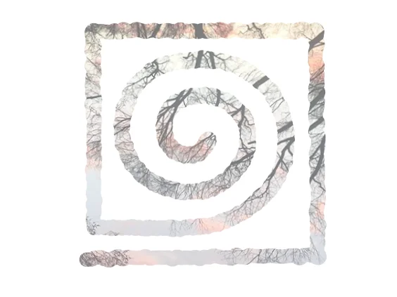

My project: an animated logo. Despite my solid white background in Layers, I keep getting a black bg after rendering. Tho I have identified the problem layer, I can't seem to correct the problem it's causing. Hoping someone can offer some ideas.
Here is the structure (as shown in screen shot): I have 2 layers directly above the bottom-level solid white BG layer: (1) Trim Paths layer with a stroked spiral path /this layer has only 3 properties: Trim Path, with only 2 keyframes, Wiggle Path and Stroke Path @ 100% opacity & Blend Mode on "Normal" (2) a photo layer /below the trim path layer/ that provides a texture in the stroked spiral path.
My animated graphics appear correctly – except for failing to render the white background layer. The layer causing the problem seems to be the Trim Paths layer, which somehow seems to be preventing the white background from showing. Is there an antidote for this?
/NOTE/ The background appears correctly in the Vimeo link... but today after making some timing corrections, the white background layer will simply not show up, and keeps rendering as black. This is a mystery to me, so I am posting in this forum for the first time.
https://vimeo.com/385593416

Yikes, that white bg was supposed to be ON when I did the screen shot – but I'd been testing the file to troubleshoot this problem and thus had it turned off temporarily. Even with it turned on, my background turns out black. The order of the layers currently is necessary as is, because the "Trees" photo (on layer beneath the problem layer "Spiral1") has to be made to show up in the stroked/trimmed path... so the photo has to be under the path layer. I appreciate your outreach, Mylenium, but need help to untangle this problem. I'm trying fiercely to find a fix. Weirdly, even placing a solid white JPG as my bottom layer doesn't help... the background still turns out black.

I'm not completely clear on your comp setup. If it were mine:
That is everything that I did to the layers*. If your background layer is not rendering and you have it turned on then it was set to a guide layer. The equivalent of a clipping mask is the track matte. The example video is easily recreated with just these few steps.

Wow… THANK YOU, Rick, for your recreation of my animated spiral graphic in a cleaner form. The Alpha Track Matte on the JPG looks like it's probably the best AE equivalent to Photoshop's Clipping Mask effect. I also didn't know about NOT using 100% white or black for h.264 output. What percentage of those colors do you suggest?
I saw your contribution, Rick, when I signed on to update my troubleshooting thread here, to say that I came up with a solution (*before* seeing your post). My solution was to PreComp the 2 layers that were creating the problem with the white background. With the JPG layer ("Trees") and the stroked layer ("Spiral1/StrokedPath") grouped into a PreComp, the white background layer showed up perfectly.
