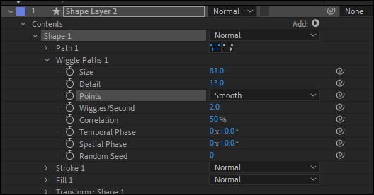

Have you tried using Wiggle Path on a Shape Layer's path?   If you add sufficient points and set the Points to Smooth, I think that's what you're describing.

Unfortuantely it's completely random, I can see it working wonders in other projects, but not this one. A sine (or cosine obviously) is basically whats needed.

I'm getting a bit too invested now, so it sounds like you want a more organic version of Warren's animation, with the end of the snake not following exactly.
If you keyframe the wiggle path's spatial phase while setting the wiggles per second to 0, the path the snake follows changes subtly (or dramatically depending on the values) so that the head looks like it is sniffing around and the tail drifts as if pushing against sand.
