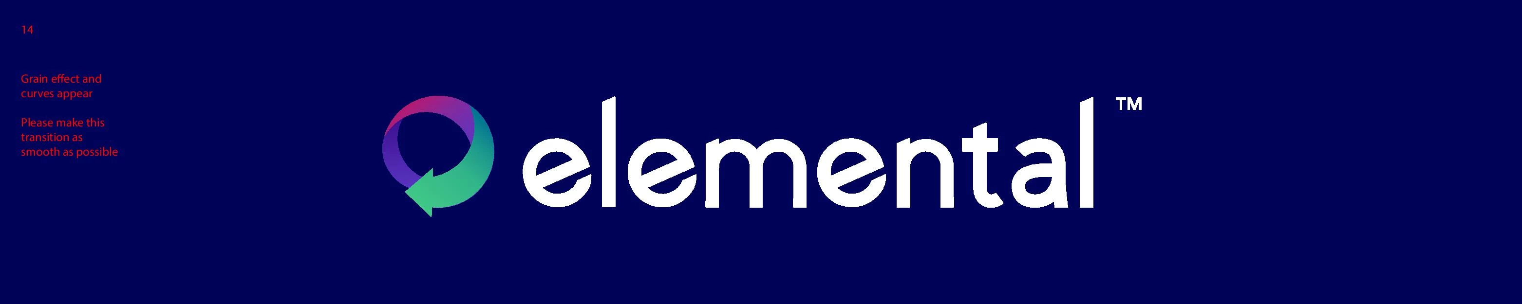

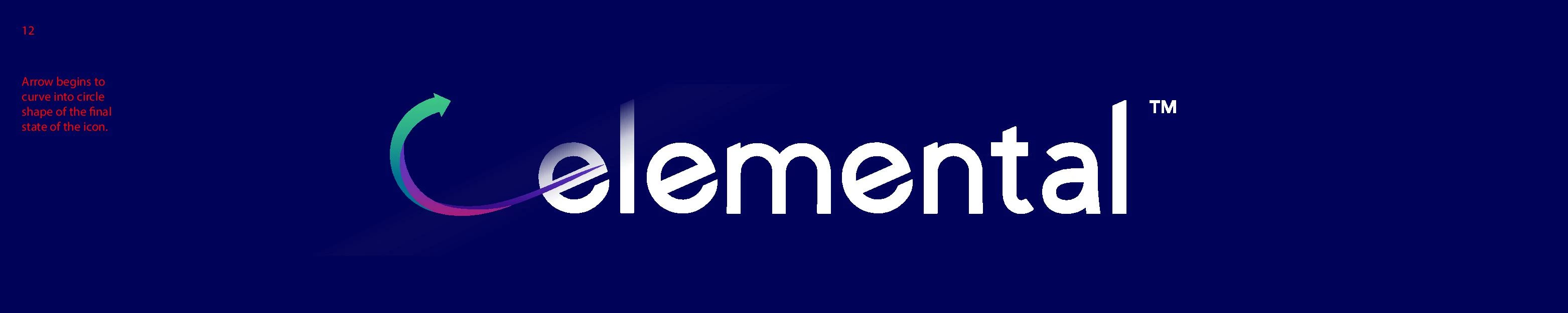

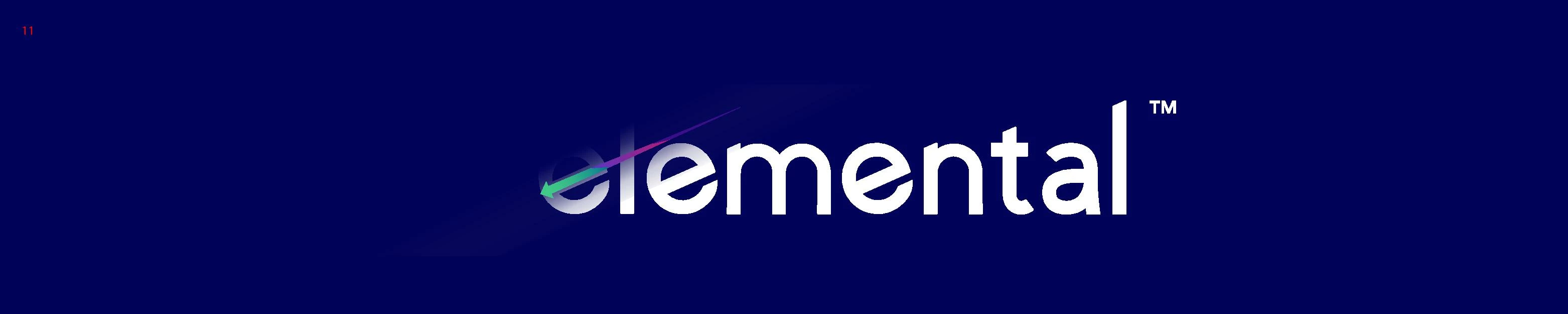

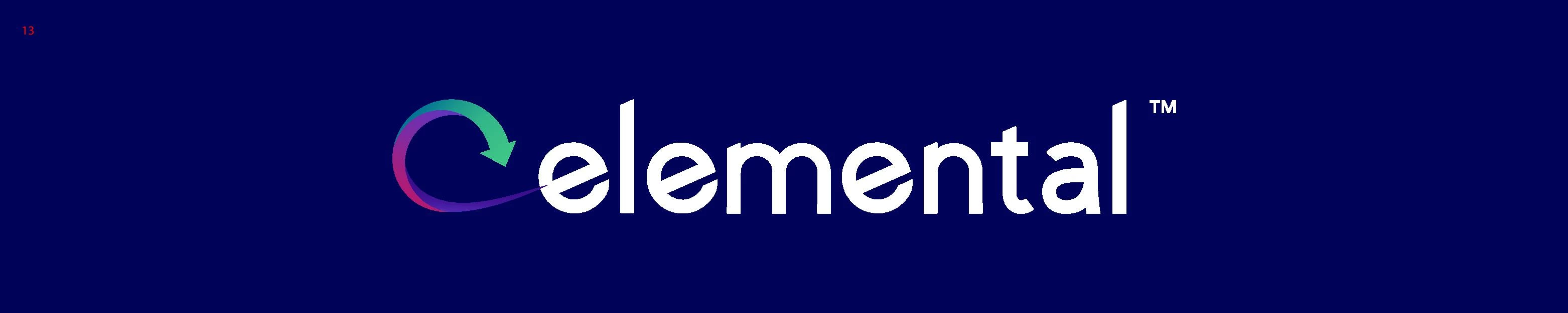

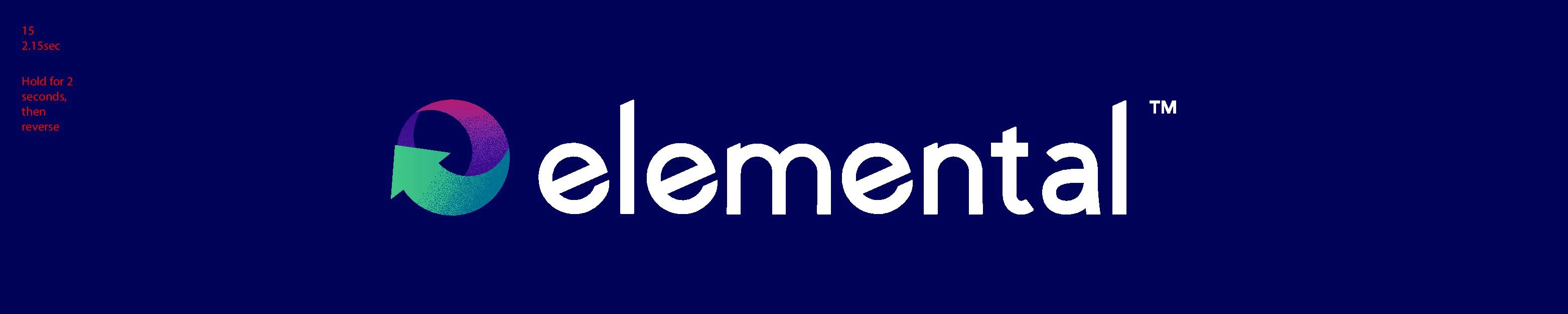

I'm currently working on a project that I need a little help with. The storyboard is attached.
I'm trying to figure out a couple of things:
1. The line needs to move across the screen revealing the logo, I've got an animated feathered mask to reveal the text however I'm not sure how to animate the arrow. Traditionally I would use a trim paths but as the arrow is sectioned into 3 gradiented bits I can't do that.
2. How to animate the arrow growing and presenting the final form. I'm guessing it would have to be a path animation but not sure if there's a quicker way!
Any help would be amazing, thank you so much!!

Since the Arrow appears to rotate and grow I would take the illustrator artwork of the Arrow and set up a blend, then release the blend to layers, set up about 30 steps, and then save the new AI file and import it as a composition retaining layer size. You can then sequence the blend to create a smooth animation. Here's an old tutorial that shows you the basics. In the latest versions of AE and AI you don't have to expand the blend, you can just select the blend, right-click in the layer panel, sequence the layers, then drag them above Layer 1.
