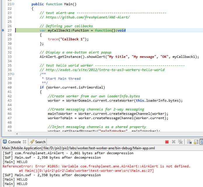

Hi Nimisha
I think it still got some issue there, here is what i got
FYI : i'm on winx64 test on device tab3 x86 atom with AIR13.76
source to reproduce
ANE : https://github.com/freshplanet/ANE-Alert/
Worker : http://esdot.ca/site/2012/intro-to-as3-workers-hello-world
and put both in constructor
both working but not together, simply comment
//AirAlert.getInstance().showAlert("My title", "My message", "OK", myCallback1);
is working without error throw but actaully all ane i've will throw error eventually after try to alloc ANE
weird part of this issue is only first alloc ANE will broken but other ANE alloc after that will be fine e.g.
// this one will throw error
new OtherANE();
// this one will working fine
in short
  1. yes, ANE is working
  2. yes, Worker is working
  3. yes, ANE is embed and not throw error until alloc
  4. yes, any ANE will get this error eventually after alloc
  5. no, Worker not working after error
  6. no, i didn't try to create Worker from other swf yet
  7. yes, error throw incorrect line, don't bother with it, like i said only alloc ANE is enough to produce this error.
workaround
  • don't alloc ANE and Worker in constructor together, let worker do their job for a while and then alloc ANE really later
do tell me if you want to me to file to bug base.
ref : http://sleepydesign.blogspot.com/2014/03/ane-daily-pitfall-ane-and-worker-dont.html
Thanks
