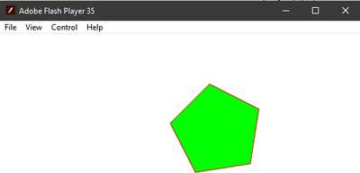

Sep 17, 2023 Sep 17, 2023
i can't know how you can click an exe and see the screenshot you showed. afaik, it's not possible.
you will see what's at the top in the screenshot below:
Explorer ,
When I drag and drop the exe back in the folder and double click, it comes up with the project and plays ok. This is what I want, But I want it to play on its own as stand alone exe on the desk top. but when it is outwith the folder it error message pops up but no program!
open your fla
change publush settings to exe only
select flash player 32
publish to a new folder

Tried with flash player 32 and win projector only. This makes air publish option unavailable. When published makes flash player.exe. With flash Icon/logo
we'll, what do you want?
