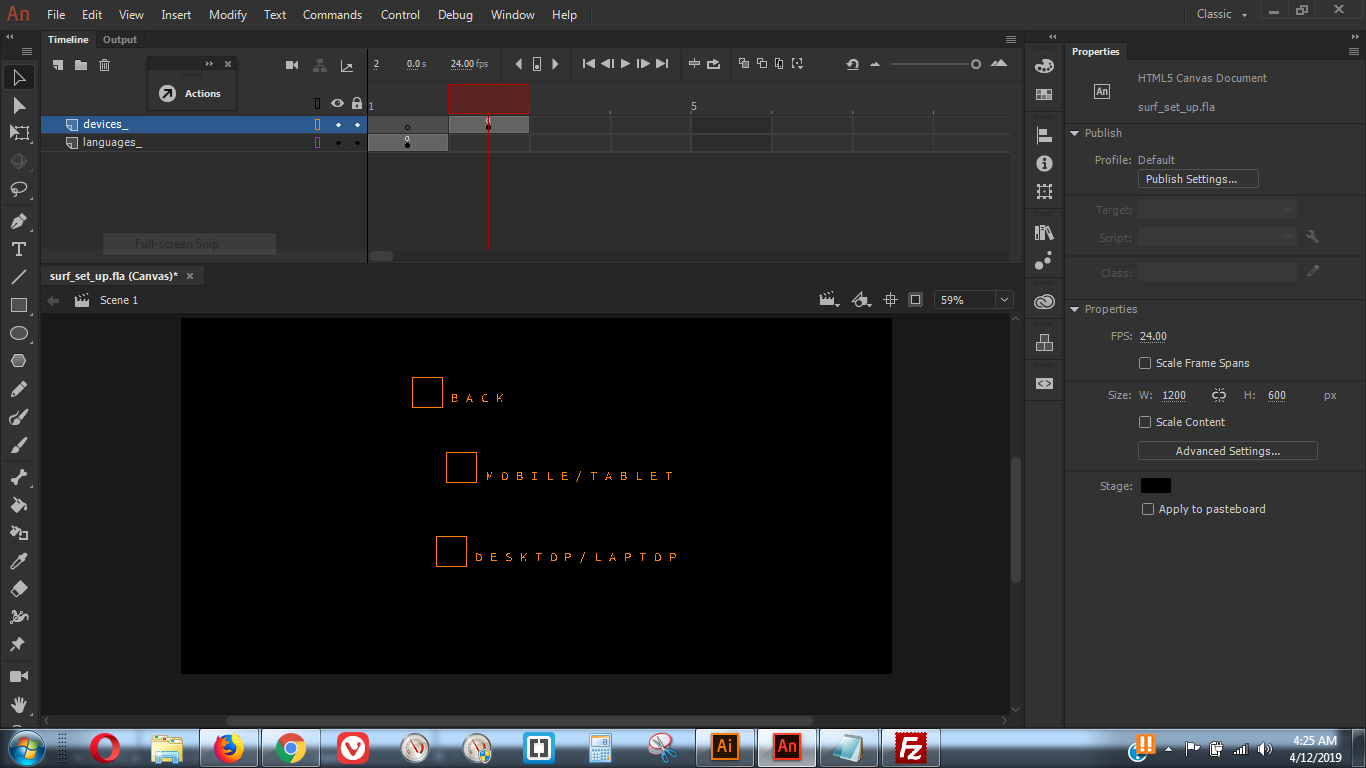

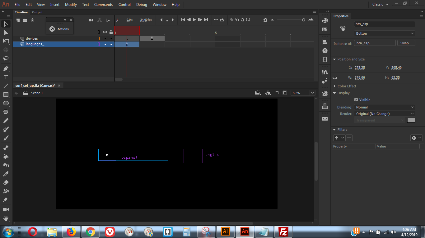

Start as you see on F1 , is two btns , english , spanish. FRAME TWO i got 3 more btns , the only code going on here is really jusyt 3 main actions being what , go to webpage , go to frame ( back and forth work ) and stop here./ so nothing major.
As I said slapped all artwork on same layer as code. Yet if that is an issue , if i put to their own layers it still generates the other issuse ( as if you try you will experince also ) being wooooooahhh lets go mental and open a crazy amount of tabs upon on the click on the spanish button.

Left spanish , right english. Spanish goes off to ck22.es , right I want to navigate along the timeline , moving through and old skool device set up check up.
So press english , that moves to next frame ( only got two frames total ) ...
then hey lets say you want go back  and go to spanish load up then ok hit back , that work ONE TIME but not second time ONLINE , it will work on local .
So you then stand there pressing it going what the heck man. ok so i press trhe spanish one then , and hey presto = ole we load up 50 tabs with ck22.es link.

NOTE WHEN MAKING INSTANCE NAME TO MY BUTTONS animate told me hey cant these name as nt valid etc etc , yet then after entering exactly same instance name as initial attempt it then accepted it. other time it did not.
MY INSTANCES NAME and BUTTON NAMES are SAME - so i have btn_english creatde as a button , then slapped it to stage , and also named it btn_english as instance. Problem ?
Not sure if my animate also might be messed up as got random issues going off all the time.

It is now NTO openiong loads of tabs up for link , press the english button to jump to frame 2 , works , pres back button , to go back to frame 1 , works also , yet you CAN NOT go after that to frame 2 again. Afetr ONE click of the english button , it does not wortk whatsoever now.
Reloade file at : surf_set_up
code ( below ) is same yet advanced layers disabled as you suggested. SOS plesase
I attach the file also
QUESTION : is frame 1 actualy frame 0 and frame 2 actualy frame 1 ?
