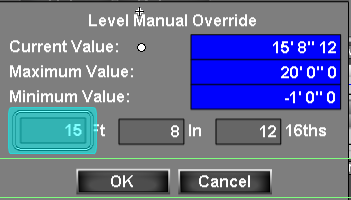

I am trying to figure out how to:
  1. A person inputs in the information in the input text
  2. They hit the enter key and
  3. it moves to the next screen.
It there a way to do this?

Thanks so much for answering.
When they click on the 15 it goes to the next screen where they put in a new number
When they put in the new number I need them to press the enter key and go to the next screen which would be 8 in
I am not sure how to handle the code you supplied as a input text object.
Thank so much for helping!
