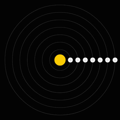

Hi.
Here is a suggestion.
Probably not what you want but at least it will give everybody a starting point.
My setup didn't require code.
I created 7 graphics for each planet and put them in separate layers in the main timeline. All layers have a duration of 36 seconds minus 1 frame in the main timeline.
Then inside of each Graphic containing the actual planet animation I extended the child timeline to a number of seconds that when divided by the total duration of the main timeline results in an integer number. In this way all the animations can loop seamlessly.
To rotate the planets I simply moved the Transformation Point to the center of the stage and set the tween to rotate CW.
And finally each planet also has a 360 degrees rotation animation of one second.
I hope it all makes sense and that it can be useful for all of you.
Regarding to Dreamweaver, export your animation as a OAM Package and you should be good to go.
For responsiveness, the best you can do is to use the options available in the Publish Settings.
Preview:
FLA download:
animate_cc_html5_planets_orbiting.zip - Google Drive
JC

Aug 17, 2018 Aug 17, 2018
Having every single planet line up on a regular basis looks really unnatural. Unless the intended output format is a looping animated GIF, it probably shouldn't be done this way. Just putting each planet in its own independently looping movieclip would give a much more natural-looking animation.
Explorer ,
Clay, I agree. That is what I'm trying to do. And, of course, I have run into problems. So, hombres brillantes, I am once again asking for help. The set up: I put the seven planets into seven independent movie clips. I created each movie clip with frames in multiples of 30 (for the frame rate) and let each run a different length; e.g., outer one is 240 frames, next one is 210 frames, etc. On the main timeline I put an instance on each movie clip on its own layer. I extended all layers on the main timeline out to 240 frames. And it looks wonderful! Until it hits frame 240. While the outer planet continues on, all the others jump back to their frame 1 origin position and start up again.
I had to turn on the looping function in the play bar area because this needs to run forever. That is the only difference I can see between my file and JC's file. His works beautifully. Mine sucks.
I've tried everything I can think of and the only thing that eliminates the jump is to make all the movie clips 240 frames. Or put all the planets into one movie clip, although this means they won't revolve correctly. If that's the only option, I'll take it.
Thank you for any brilliance you can give me.
LEGEND ,
Movieclip timelines run independently of their parent timeline. So put them all on a timeline that's a single frame.
Explorer ,
Clay, Is that the main timeline? I tried making that one frame long and the animation wouldn't run at all. I remember having to extend the main timeline out to the longest movie clip, but things might have changed. That was a long time ago. Should I put all the movie clips on the same timeline instead of separate layers? Thank you for your help.
LEGEND ,
It doesn't matter which timeline. The planet movieclips are restarting because the timeline they're in is restarting. If you put them in a timeline that's not restarting, they won't restart. It could be a single-frame timeline, or a longer timeline with a this.stop(); at the end, whatever.
I must stress that this only works if your animations are in movie clip symbols, not graphic symbols.
Explorer ,
And of course I used a graphic symbol. Thank you clearing up my confusion. Back to work on this animation. I hope I get it this time. Thank you Clay and thank you Colin and JC for all the help you've given me.
