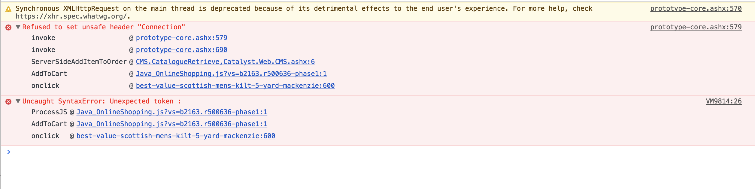

This is another conflict caused by the usual terribly coded "prototype-core.ashx" used on the shopping cart functionality through BC , however the implementation of Google's LD+JSON seems quite impossible with the problems coming all the time regards BC scripting.

Everything works just fine without the above but once its added to the head or body of the template I just get errors once clicked on "addToCart" custom scripts wont run.
Everything is clear of conflicts but regards this specific JSON from Google things don't go well, even worse you cannot add javascript to the ld+json script it becomes unrecognised and wont render by Google.
Please check the demo: Dropbox - BC and Google LD+JSON Conflict.mp4
In response to OP, in case anyone else comes searching for the same error:
BC will attempt to 'eval' inline scripts when redrawing the product after adding to cart, which will break on "application/ld+json" types. To resolve this I include an override of the BC function the excludes that type:
ProcessJS = function (ele) { for (var t = "", x = ele.getElementsByTagName("script"), i = 0; i < x.length; i++) { if (x.getAttribute("type") !== "application/ld+json") t = t + "\n" + x.text; }...
