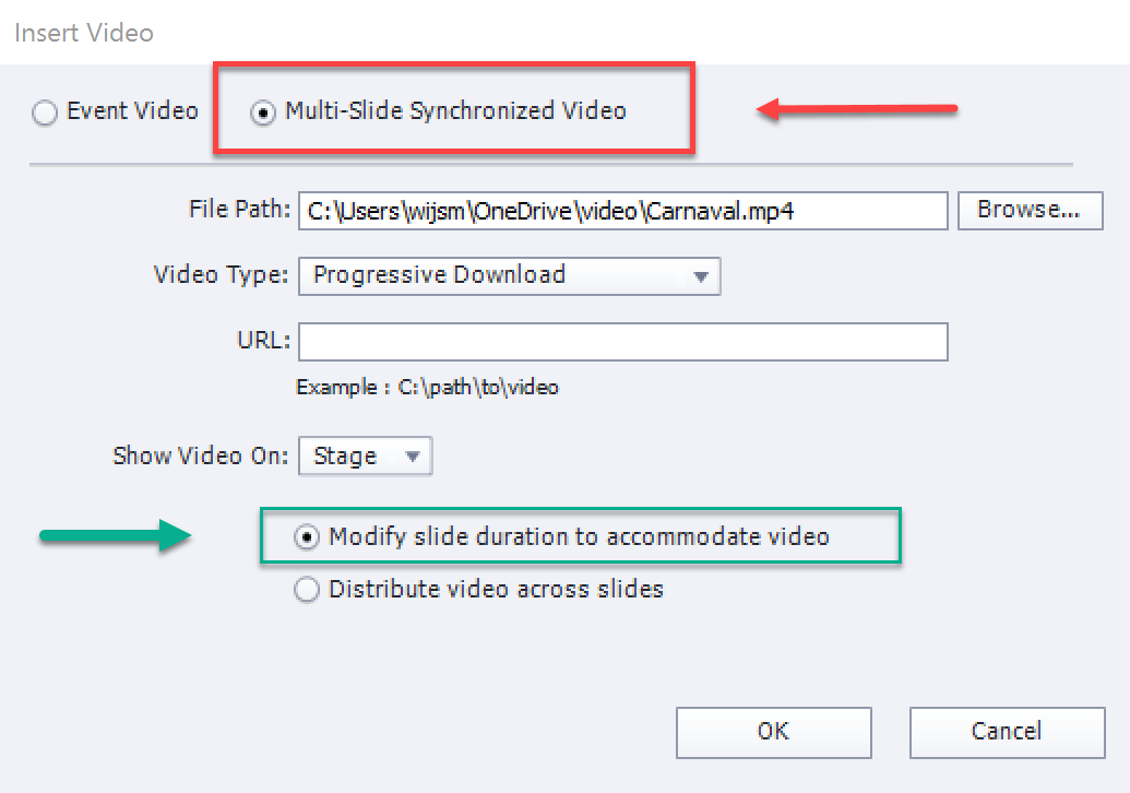

Anyhow you will have to insert video as synchronized video, so that it can be controlled by Captivate's timeline. Event video is just like a link to a youtube video somewhere, without any other controlling possiblities than those in the control panel which is added to event video. Inserting a synchorinzed video is just clicking another radio button when inserting the video, and extending the duration of the slide to the length of the video. That is all:
You can slso distribute the video across multiple slides, work flow which could help by defining keypoints.

In that case, please insert the video as mutlislide synchronized video, distributed over multiple slides. Create those slides fbefore inserting the video. With the Vidoe management you'll be able to move the slide separator markers to the wanted tocation in the video.
It is then up to you to add more objects on the video slides (like a button to pause at the end, which I would put on the used master slide), to add quiz slides etc. I really do not recommend to use event video, unless you split that video up in a video application in the chunks you want.
