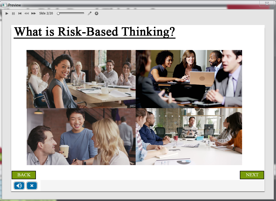

I am trying to create an advanced action that will enable, but also disable at the same time. I posted on here before, about this same slide but decided to change a few things.
This is the slide that I am using. Once you click on each picture, the picture will grey out and a box will appear.
When this box is up, I don't want the learner to be able to click on another box. I want them to click the back button and then click on another box. I also don't want them to be able to click on the same box twice. Once it is clicked, it is disabled. I also don't want to show the next button until all items are clicked. I am using the same back button for all of the boxes that will be popping up.

It is not possible to disable a group of interactive objects (one of my feature requests). You will not be able to use shared actions neither in this caseµ. Since ou didn't tell which version you are using, will not post any screenshots, but write out the actions as text.
Create 4 user variables with a default value of 0, one for each of the images to be clicked.
For the Back button, the action is pretty simple:
   HIde Gr_Boxes                  group the popup boxes, you can use one command instead of several
   Enable One
   Enable Two
   Enable Three
   Enable Four
For the to be clicked images, you'll need a conditional action with 2 decisions
First decision is not conditional:
  Assign v_one with 1                  the variable associated with this image, has to be edited in the duplicates (you need 4 in total)
  Disable One
   Disable Two
  Disable Three
   Disable Four
   Show Box_one                 has to be edited in the duplicates
Second decision is conditional
   IF v_one is equal to 1  AND
        v_two is equal to 1  AND
         v_three is equal to 1  AND
         v_four is equal to 1
    Show Bt_Next
