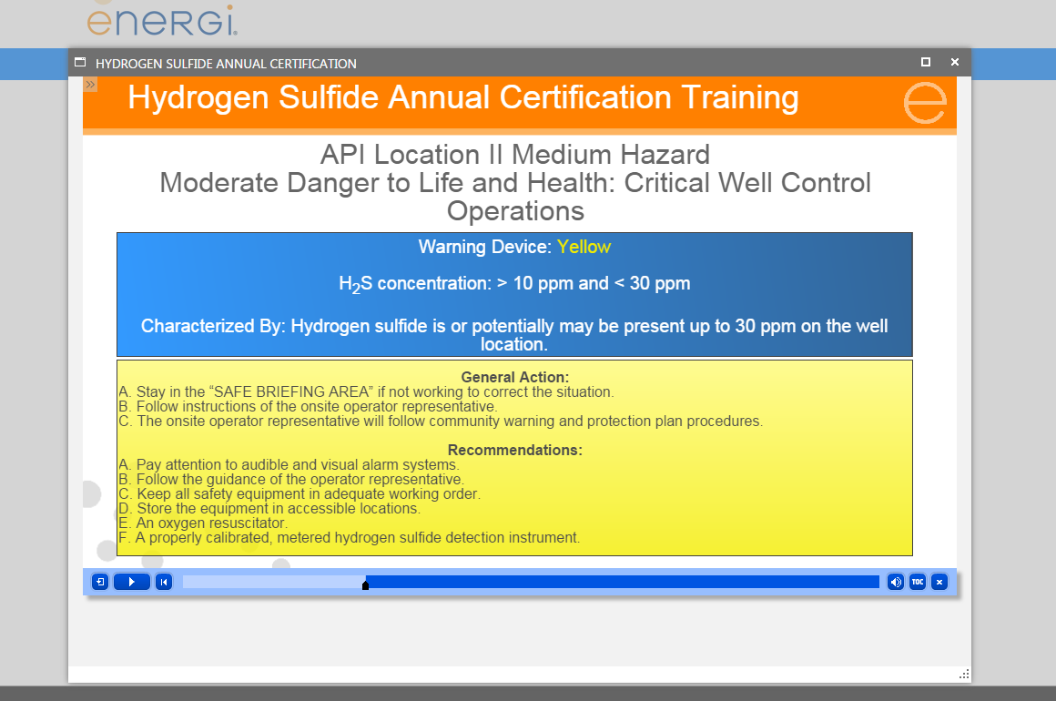

Not sure why this is happening, but I could use some help!   When I put the information in Captivate, it looks like this (only one of several examples)
but when it is uploaded to the LMS, it shows this:
Several times the formatting in Captivate does not show in LMS.  Any thoughts?

OK, I made a new course, using just the slides that I saw formatting issues on.  Put them on the cloud and the same formatting issues were seen. For example:
  (from Cloud)
Instead of
( From Captivate)

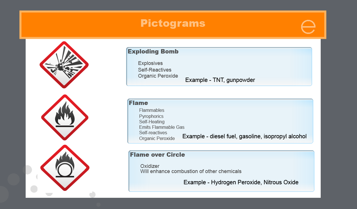

Thanks RodWard, just downloaded the trail of Captivate 9 and here is what I found:
No difference.  Here is a screen shot from Captivate 8  in captivate
Same course run in Captivate 9 in the SCORM cloud Preview
Note that the Titles should be in arial black, the first line in the top two boxes is not indented. (i did not play the slide to the conclusion, when I took the snippet, which is why the third example is not there.)
Another slide to show the issues.(Captivate 8 in first slide, Captivate 9 LMS Preview in SCORM in second)
The issues with the arrows was corrected in Captivate 9.
