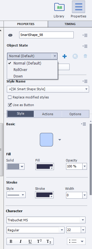

Thank you for your quick response it was helpful. Somehow I had overlooked the Object State drop down box on the preferences panel. Here's a screenshot of where I made the change:

I always point to the Object Style Manager because I know many users don't even know about its existence. I will try to explain why. In your screenshot I see that the default style for this shape button is overridden (look at the + sign appearing in the Style Name field). That is very bad practice, and the result of changing a style for one button, locally. If you want another button to have the same look, you will have to repeat that process again. It is much better to either change the default style in the OSM or create a new style. That way you will save a lot of time later on if you (or the client) decides to change some aspects of that style. Examples:
Such changes when done in the Object Style manager to the style that is applied to all your buttons, and not overridden, will be applied immediately to all your buttons.
