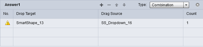

Adobe Employee ,
Aug 16, 2016 Aug 16, 2016
Hi Steve,
The problem could be, your Drag and drop matching on slide is not in sync with the matches set in "Set Correct Answers". You might see the warning icon as similar to the image i have attached with this post. So please find such an entry and delete that row or correct the matching. Drag and Drop Set CorrectAns Dialog.PNG
The above conditions might be happening to you when you try to delete a drop target or drag source from the DND configured slide.
Thanks
Devraj
Adobe Captivate Engineering Team

The problem I was having was almost certainly due to having some deleted drag sources and drop targets that were affecting the behavior of new drop targets and drag sources that I had added.
